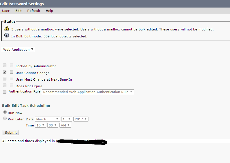

im trying to allow users to change their pin under password settings but whenever i use bulk edit to enable it for users  and choose to run it now it never starts and it shows "Task not started" , not sure if im missing something here ?

1-first i check-mark the users i want to apply configuration to under "users".
2-i choose "bulk edit" at the bottom of the page.
3-i go to password settings then i uncheck "User Cannot Change"
4-i choose "run now" then press "submit"
5-i go to "task management" but it list task as "task not started" ?!?!

In the screenshots above i can see that you have ticked only one box. We have to tick both the boxes in front of user cannot change to run the task.
Try that and update. Also let us know the role that the user has , which is being used to change the password.
