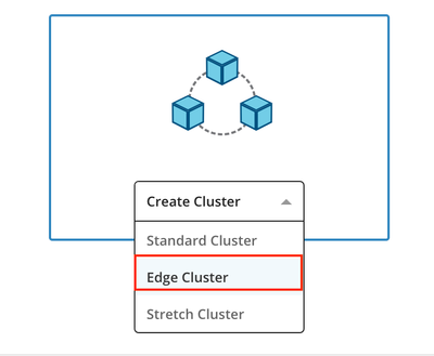

Hi @teal.cheng ,
I'm deploying a new Hyperflex edge cluster for a Lab environment which is completely cut off from all normal domain services.
When deploying HX Edge, you must choose "Edge Cluster"
I'm running the deployment from the appliance, however the validations are failing as Failed in Task: 'Failed to Configure Server Profile Association.' with Error: 'Unknown error occurred.'
This is because it is trying to assign Server Profiles - this to me indicates you didn't choose the Edge option when running the installer. (Forgive me if I'm wrong - I have no way to test at the moment)
RedNectar aka Chris Welsh.
Hi @RedNectar,
I was choose "Edge Cluster" to deploying HX Edge, but got this issue.
