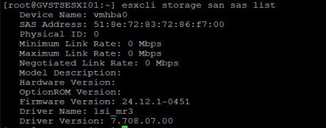

I've taken some pictures which hopefully helps show the details...etc.
Is it just a case of the firmware on the drives limiting the drive queue depth? (ie, is it by design?)

Maybe try updating the megaraid_sas driver/vib (or confirm it matches the Cisco HCL),,, and then disable the MR3 driver that the system defaults to.  Believe I have seen some cases were different drivers seemed to impact the reported queue depth on the drives.
Kirk...
I've played with some different versions of drivers (and lsi_mr3 vs megaraid_sas) and it doesn't appear to have made a difference.
