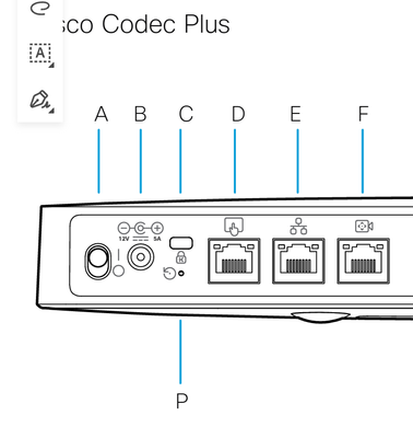

Are you sure you have the ethernet cable connected to the right port on the codec? What codec are you using? On the Room Kit Plus you should be using the right most of the three network ports.
