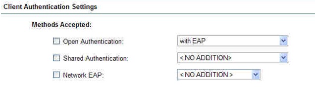

When configuring an SSID with EAP/802.1X on an autonomous AP, we are given the choice between Network EAP and Open Authentication with EAP (or both).
On the CLI, we would say
dot11 ssid whatever
    authentication open eap eap_methods
    authentication network-eap eap_methods
In configuration guide it is not completely clear, here is a quick summary of which one to choose and when.

So it seems that Network EAP = LEAP and Open authentication with EAP = Any other EAP. This is something we see when checking Network EAP: the popup window clearly states that if we use EAP-FAST or any other EAP (than LEAP), we should check Open with EAP. We can of course check both when we want to allow LEAP and another EAP, but we will not be able to authenticate using EAP-FAST if we choose Network EAP only.
There is one exception though. for long, LEAP used to be the default "secure" authentication method. This makes that some old clients (for example access points!) need to be offered LEAP to get started (or turned on, name it the way you like). In other words, if we build a wireless link between 2 APs, for a repeater, bridge or Workgroup Bridge configuration, and if we use 802.1X on that link, we need to offer LEAP (i.e Network EAP) for the secure authentication to be used. So we can offer Network EAP, or Network EAP and Open with EAP, but we  should not offer just Open with EAP.

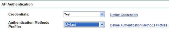

This is going to use LEAP only. If we want to use another EAP, for example EAP-FAST, we need to empty that EAP Client field (it cannot be used in combination with another method), then use the AP Authentication feature.
In this page, we define credentials and method. We can pick up several methods if we want. Then from the SSID page, we can call these methods:
In the CLI, this is:
dot11 ssid whatever
    dot1x credentials Test
    dot1x eap profile Myfast
exit
eap profile Myfast
  method fast
dot1x credentials test
  username cisco
  password cisco
So we offer both LEAP and Open with EAP, and using the newer AP Authentication method allows us to use the credentials we defined, and use the most secure method selected. In this example, we use EAP FAST only, so that's the one we'll use. Of course, the RADIUS to which you main AP points (local RADIUS on the main APor external RADIUS) needs to allow that method.
