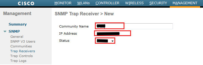

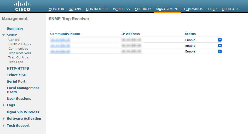

Solution
 The management tool needs to be add in the WLC as a "TRAP RECEIVER".
Source
Cisco Wireless LAN Controller Configuration Guide, Release 7.4 - Configuring SNMP
