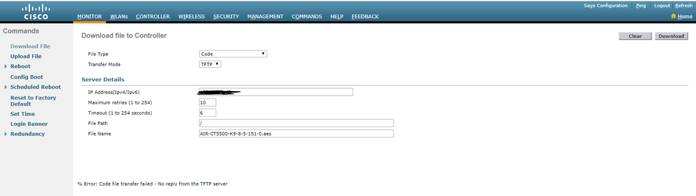

I'm having problems with the TFTP syntax when attempting to download code to WLC.  What is wrong with this?
Here are screenshots of my TFTP server config and the WLC with error.
I had to copy code from TFTP server to local router bootflash, then I copied code from router to WLC. I left file path field empty on the WLC and the copy to WLC was successfulCapture.PNG

IP reach-ability exists between these devices. There is no firewall rule.
You mean, you can ping TFTP server from the controller and vice versa?
I would check TFTP server IP binding & security settings to make sure they configured appropriately.
I would also try code upgrade via CLI.

See what msg you got once you go with CLI approach. CLI approach is always recommended as it gives some output why is it failing.
transfer download mode tftp
transfer download datatype code
transfer download serverip <tftp_srv_ip>
transfer download path ./
transfer downlaod filename AIR-CT5500-K9-8-5-151-0.aes
transfer download start
y

is that the correct path directory? file is located in C:\TFTP-Root

Have had issues with solarwinds TFTP server with large files before.
Can you try SFTP? or HTTP to download the file
If you have a MACOS try Transfer (https://www.adriangranados.com/apps/transfer)

Path ./
Or as Rasika says try the CLI

Windows Firewall correctly configured to allow UDP 69 or the application?
Since solarwinds tftp server displays it LOG on that same screen.. what did it say?
What version? I'm on 8.2.7 and the screens are different..
logs on Solarwinds dont show any activity.   I believe that my syntax for path directory is not correct.
windows firewall is off and I dont have any mcafee software running on this server.
SW logs the....  attempt to connect.  If the path was wrong it would log invalid file, or something like that.
if you instance is not logging anything then I suspect that the wlc has not established a link to your tftp server.  On you desktop is it not?

Have you tried another TFTP program like  TFTPd64? it's free and works great and very ease to setup
I would also try using FTP to download the code to the WLC
