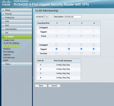

I have the following setup:
  1. RVS 4000 with all 4 ports configured as trunk and PVID 1. The router has 3 VLANs
    1. VLAN 1 - Management/Untagged - IP range 192.168.1.100/255.255.255.0 - WLC static IP - 192.168.1.3, Gateway - 192.168.1.1
    2. VLAN 2 - IoT - IP range 192.168.2.100/255.255.255.0 - WLC static IP - 192.168.2.3, Gateway - 192.168.2.1
    3. VLAN 3 - Guest - IP range 192.168.3.100/255.255.255.0 - WLC static IP - 192.168.3.3, Gateway - 192.168.3.1
  2. WLC 2504 with v8.5.182.0 and AP 2702 connected to port 3 (POE) and WLC port 1 connected to port 1 of RVS 4000 (trunk).
  3. WLC has SSIDs for each VLAN.
  4. I have enabled Inter-VLAN routing enabled for testing.
The main issue is whenever I connect a client (iPhone 13/laptop) to SSID for VLAN 2 and 3, I never get an IP. The packet somehow is not routed properly to RVS 4000 router. If I connect to VLAN 1 SSID everything works fine.
RVS 4000 Configuration
WLC 2504 Configuration
FlexConnect VLAN template

sardarjion
I figured out the issue. it seems even when RVS was set to trunk mode, I had to explicitly set the tagged traffic for vlan 2 and 3. Below are screenshots. Now, I am getting all the right IPs in SSIDs.

Are you sure that Port connected to WLC (from RVS router) is a trunk port ?
I think this port is still in access mode!
I have posted the snapshot from RVS in the original post. Posting it again with more details.
Thanks.

sardarjion
