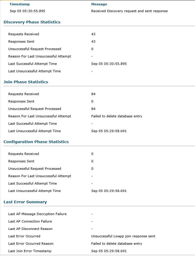

This is next situation:
(I used different IP-s then I stated in my previous post - but IPs are good, APs took correct address from correct DHCP.)
WLC Software version: 8.3.143.0

doing a community search found a similar issue with 3702's..  seems it was a new package and the WLC's licensing did not take..
Each AP show up as 'not joined' and have a reason for unsuccessful attempt as failed to delete database entry.
https://community.cisco.com/t5/other-wireless-mobility-subjects/aps-not-joining-a-new-5520-controller/td-p/3016972
in that case
"Found the issue this morning. I checked the licenses and they weren't activated. The GUI showed 1500 AP license, but they weren't accepted.  Sort of a silly exercise to accept something that I obviously wanted, but its resolved now so I am good to ."
coincidence?
I feel so embarrassed...
It's like... you wonder why car doesn't start... maybe needs fuel?
Activated licenses - everything works flawless :)
