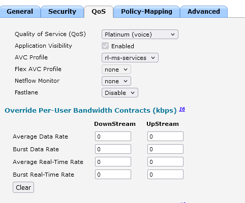

Client -> AP18328 -> Cat 9300 -> ISR4300. No qos config/implicit trust on the 9300, 4300 doesnt do any ingress marking (i do the monitor capture ingress on the ap-mgmt subinterface of the router).Skjermbilde 2021-09-14 kl. 08.21.33.png
Pls share WLAN QoS tab configuration. I hope you set it to Platinum
Rasika
This is the config for the SSID that carries the Teams-traffic.
Skjermbilde 2021-09-14 kl. 08.42.21.pngSkjermbilde 2021-09-14 kl. 08.42.14.png
Do you implement any remarking policies ? I can see there is an AVC policy, what does it do?
Rasika
Oh, sorry. No, the rl-ms-services only ratelimits ms-services and updates to not overwhelm our wan. No remarking done in avc.
