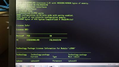

各位大神,我有一台 ISR4321-SEC/K9,不小心把securityk9许可弄丢了,现在显示None,ipbasek9许可正常!. 请问如何找回或帮我找回一下。万分感谢!!!!

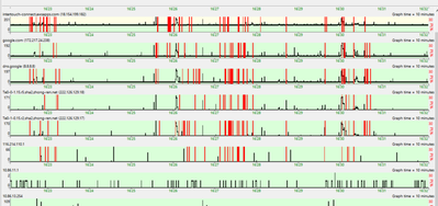

I have two PPPoE connections, WAN1 and WAN2, each with an upload bandwidth of 50Mbps. There are no issues with OpenWRT, but with the Cisco router, WAN2's upload affects WAN1. Router-C1111#show pppoe session all Total PPPoE sessions 2 session id: ...
Router-C1111#show pppoe session all Total PPPoE sessions 2 session id: 1 local MAC address: xxxx.xxxx.xxxx,, remote MAC address: xxxx.xxxx.xxxx, virtual access interface: Vi3, outgoing interface: Gi0/0/0 VLAN Priority: 0 77578 packets sent,...
