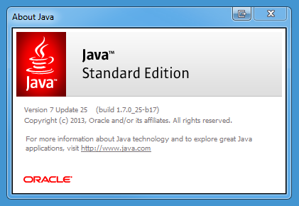

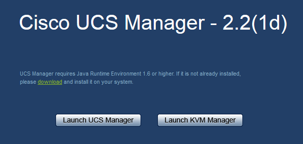

I looked over my script and I cannot reproduce the issue you are having.  I even upgraded by PowerTool module to the same version.  I can only ask a few questions.
1 - What version is the UCSM?
2 - What version of Java do you have installed?
Not applicable
Hi Joe,
1. 2.2(1d) as shown here:
2. Java 7 Update 25
Thanks,
Amir
joemar
Level 2
Level 2
Those should work.  I'm sorry but I don't know 'why' this isn't working for you.  Can you confirm that you can open the UCSM GUI through the web page?
Not applicable
I can definitely open the UCSM GUI.  Let's leave it as one of life's unanswered questions! : )

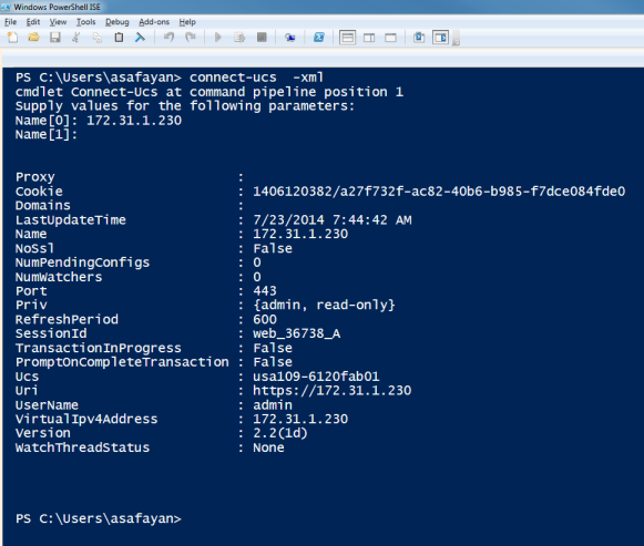

reswaran
Please run ‘connect-ucs -xml’ in powertool window and send the o/p.
Not applicable
Hi Reswaran,
Very grateful for your diligence on this.  Here is the ouput:
