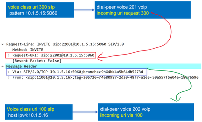

Integrating a Local Gateway for Webex Calling with an existing On-premise Cisco Unified CM involves the use of the Voice Class URI on the Local Gateway for inbound dial peer matching for calls coming from Webex Calling, CUCM and PSTN. The Voice Class URI allows more control and more flexibility to configure the selection of inbound dial peers based on various of SIP Header.
In addition the Dial Peer Group is used further to better control the outbound dial peer selection.
The Dial Peer Group DPG associated to the inbound dial peer provide the matching outbound dial peer once the inbound dial peer is selected.
The packet capture shows mostly the Request-URI and Via portions used in this type of deployment and the corresponding IOS commands.
Below Dial Peers configuration on the Local Gateway in this type of deployment.
