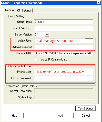

               - Click in Group> Add
2- Enter the information required; The IP address must be the Publisher.

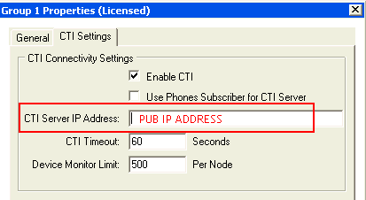

3- Click in the CTI settings TAB and enable CTI. The Publisher IP address will auto populate

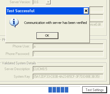

4- Click in Test Settings and a confirmation will appear. Click OK and then save.

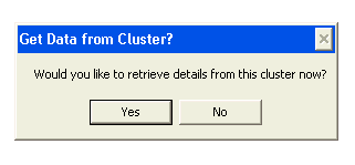

5- Accept to retrieve the Cluster Settings in the next pop up.

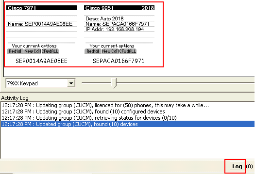

6- Phones will appear in the screen and display the basic settings. Click in the Log window to see the messages.
