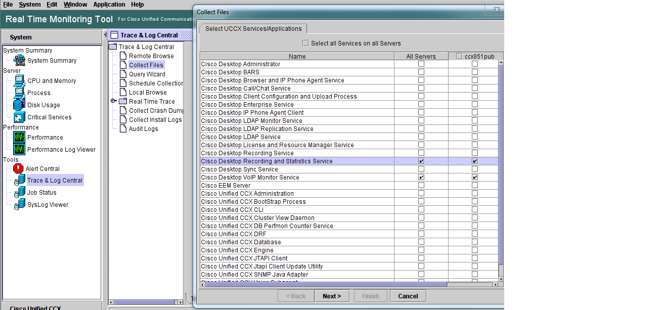

9)From RTMT tool collect the “Cisco Desktop Recording and Statistics Service”  and “Cisco Desktop VOIP Monitor Service” .

Collect the Packet capture logs from the RTMT tool .
