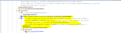

Here's a sceenshot of my original script where the queuing happening.
Please let me know if I am missing anything.

It looks like you are getting the original CSQ name from enterprise data in the callback script. I would suggest that you dequeue the caller from the original CSQ once you have confirmed the callback number. I am not sure where the dequeue in the callback CSQ is being generated yet.
As you can see, I am using a subflow to send the CSQ information to Callback script. I am also using session to communicate the CSQ detail to the sub script where the callback calls are being queued.
Could you please tell me how and where I have to dequeue the call in the original and callback script?

I would do it in the sub-flow prior to terminating the original call.
You do that with the dequeue step
So I need to dequeue first then terminate the call in the sub-flow script?
You have a terminate step in multiple places. If the the call is in queue and it terminated prior to being delivered to an agent, that is an abandon. I think that is the right place based on script interaction I see.

If you want to terminate the call, that isn't a problem. The dequeue MUST come before the terminate to have any effect.

As you can see in the script, when the agent becomes available, the systems asks the agent to press any keys to connect to the customer but what I am being asked is to remove all interactions with the agents meaning removing the press any key to connect to the customer statement. We want the systems calls the customer when he/she is the next in the queue. System needs to call the customer and wait for the next agent to become available. Could you please help me to make this work?
Thanks,
MK
There are two pieces to that. You could drive when to place the call back based on either estimated wait time or position in queue.
Getting rid of the prompt would be removing the prompt and just connecting the placed call to the agent.
