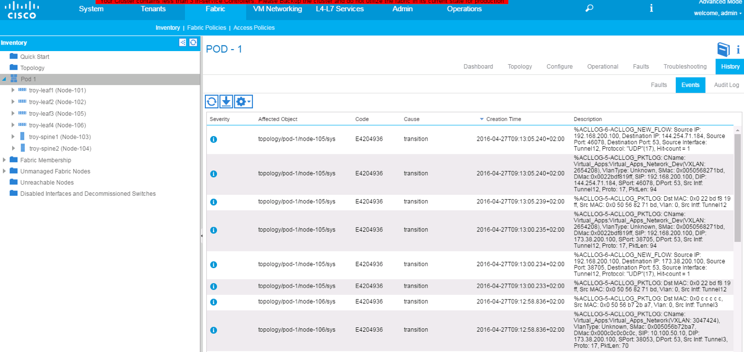

From further input from one of our experts, you may have to "enable" feature by going to Fabric -> Fabric Policies -> Monitoring Policies -> Common Policy -> Syslog Message Policies -> Policy for system syslog messages -> Change ‘default’ to ‘information’. Then you can also view the logs in  the GUI by going to Fabric -> Inventory -> POD 1 -> History -> Events.  It will be logged as ACLLOG, see the attached image.

Does the above configuration work for ACI Version: 2.2(1o)? I tried it in my lab but I didn't get any entry in the Event tab.
Thanks,
Helena.
I'll answer myself: it do work..I was doing the wrong test and not hiting a contract.
