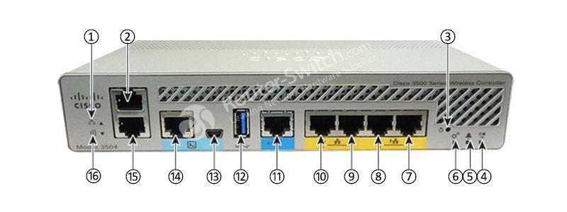

I have an issue with an AIR-CT3504 Unit.
When I start an image in the device, this show me the next init message before promt:
kukri_poe_reg_rd: TWSI Read Failed !!!
(Bus1, Dev 0x21, offset 0x12)
Failed to read PoE reg. 0x12.
Failed to config Kukri PoE.
PP0:~CONSOLE-> Enabling [NO_WPTR]
Initialization Complete
I don´t know exactly what does mean that.
I´m testing my unit, but i´m not sure how can I probe the ports.
Has anyone had a similar problem?
Does this problem have a solution?
Aditional info:
LED Alarm are always on when I power on my unit.
I don´t know how to solve this issue.
Thanks a lot
Axel.
