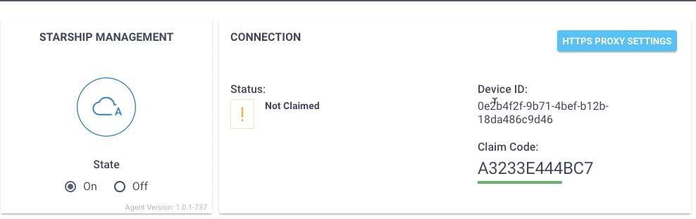

  • Note that the "Device ID" and "Claim Code" requested when claiming a device will need to be captured from the device in the menus mentioned above.  Here is an example screen shot:

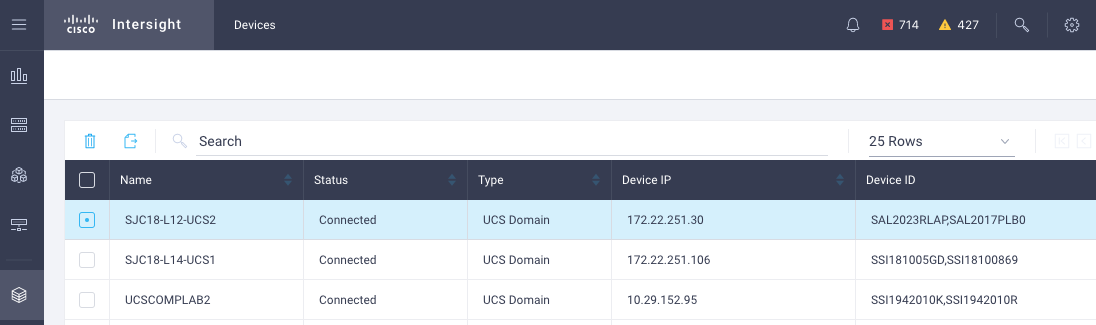

Deleting (Unclaiming) a Device
  • The following steps can be used to remove a device from an account:
    1. Navigate to the Devices menu in Intersight
    2. Select the device (or multiple devices) using the checkbox to the left of the device Name
    3. Click the delete icon Screen Shot 2017-09-29 at 1.17.38 PM.png at the top left of the devices table and confirm to remove the device:

I followed all of the steps to connect my HX 2.5 cluster to Starship, but Starship shows no cluster info at all, and HX Connect still shows as unclaimed.  Is there a substantial delay once HX is joined to Starship.
dsoper
There will not be significant delay if the claim has been successful.  Can you let me know which of these steps had an issue?
  1. Security Code was visible on the device
  2. Security Code entered as "Claim Code" along with other device data at https://ucs-starship.com
  3. Account created within Starship (Beam Me Up! screen visible)
alamatth
Thanks David. Yes, all of those things were done. I can see my cluster as a claimed device within the StarShip portal, but when I look at the cloud connecter on my HX Connect it doesn't show claimed. This is a lab connected to the Cisco prod network using the lab proxy to get internet access. Could any of that be causing the issue?

Hello Henrik. Eventually everything showed up. Not sure what changed or why it took so long, but it is working now.
