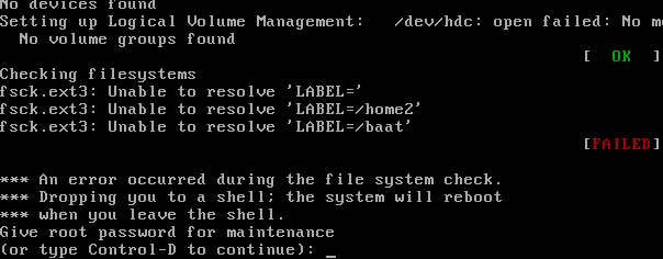

Interrupt remapping is a feature implemented in Intel VT-d or AMD IOMMU that provides isolation and compatibility for the Hypervisor to Direct IO to specific CPU through another mapping layer which allows software to control (mainly) the destination and vector for the Interrupts.  This feature is enabled by default on ESXi 4.1 and ESXi 5.0. It's known that some vendors architectures including UCS have compatibility problems with Interrupt Remapping Functionality. The Virtual Machine guess OS will randomly loose access to the underlying storage which will compromise the integrity of the file system. VM OS that gets corrupted and report filesystem inconsistencies due to problems with Interrupt Remapping might need to be reinstalled.

Virtual Machines might report file system inconsistencies and might request a forced File system check to run.
