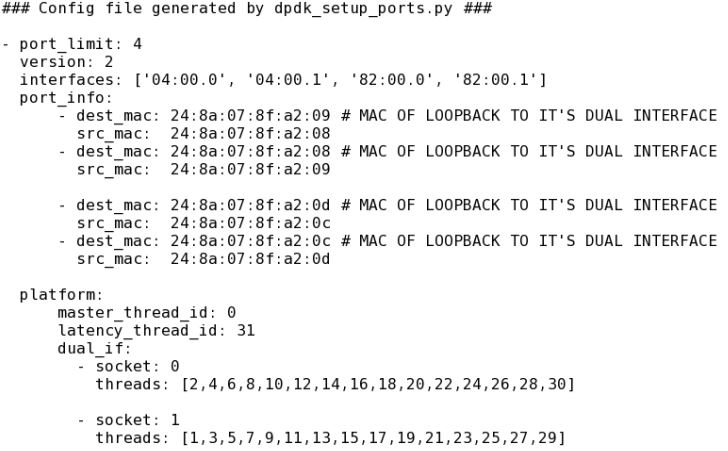

TRex Configuration File:
Partial Mellanox Application Mix YAML Configuration:
