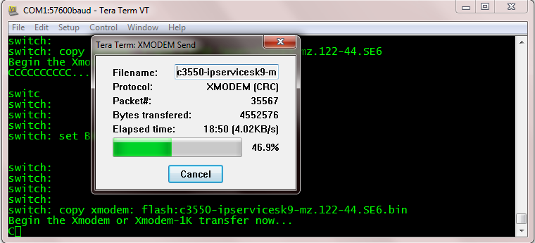

At this point, you need to choose the file location from the terminal  program. Go under File -> Transfer -> Xmodem -> Send and  choose the file that you wish the transfer. The transfer will start and  you will see a transfer window pop up like this:
Once completed, you should get a prompt back to your ROMMON:
