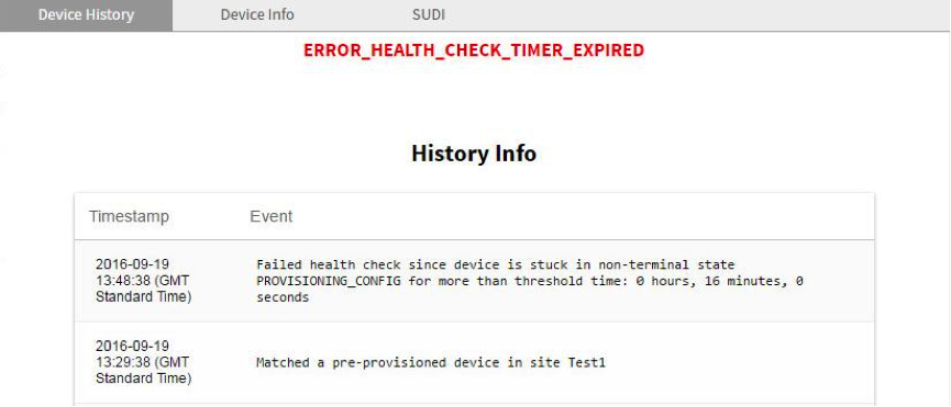

Problem
If you have "aaa command authorization" in a configuration file you will seen the screen shot below.
Strangely, although APIC-EM thinks the process has failed, you will see the configuration file looks correct (which it is).
Why is this happening?
  • Once you enable command authorization, the switch needs a username to authorize the commands it is running.
  • After the configuration file is downloaded to the network-device, the final step is to "write mem" and save the configuration.
  • Of course, this command will be authorized.
  • As the PnP process originates from the network-device, it has never been logged into, so does not have a valid username to authorize any exec commands. (If you look at the ISE logs, you will see a user called "async" is being used for the commands).
