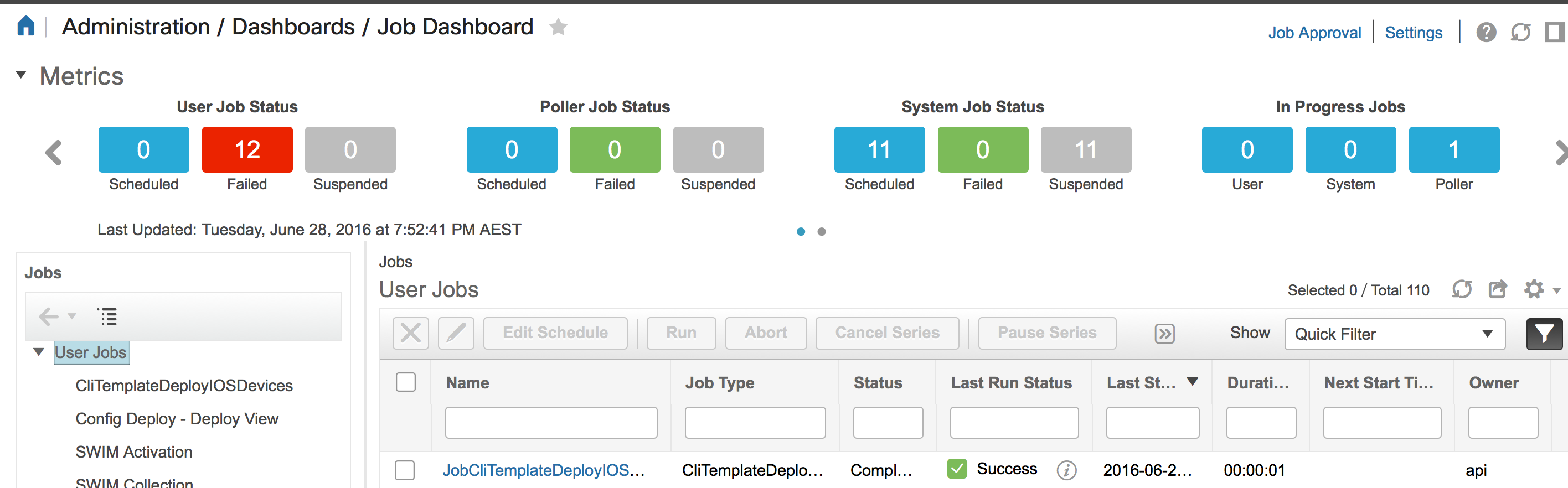

The job is also displayed in the PI job Dashboard.  Note the user is “api”, and that it was successful.  The interface on the switch has now been assigned to vlan 8.
