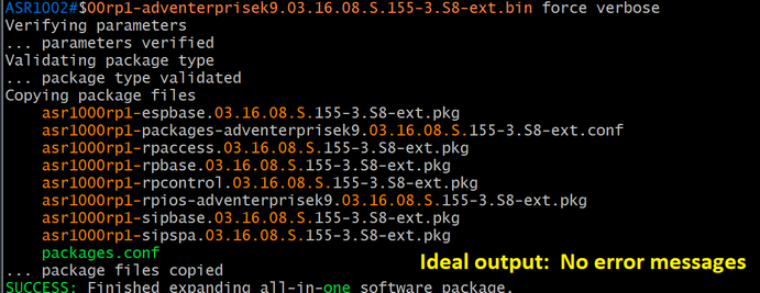

  1. Initiate Install Mode (Non-Disruptive/Does NOT Reboot)
request platform software package expand file bootflash:filename.bin force verbose
IMPORTANT
  • If the file extraction is successful (or not), the last two lines will display the result.

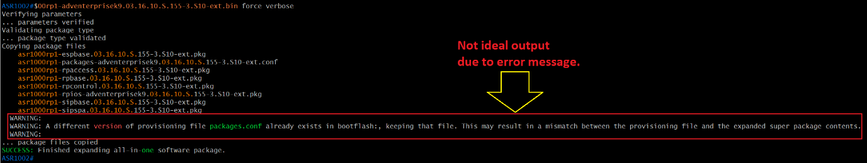

  • Go to the GOTCHA section if the following WARNING message (image below) appears:

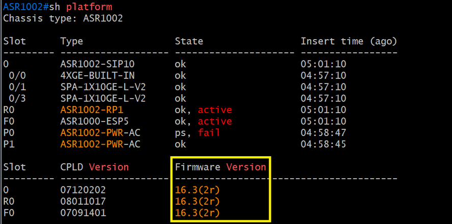

  1. Check current ROMMON firmware:  sh platform

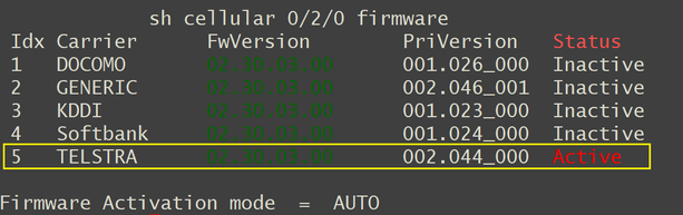

  1. Reboot the router for the firmware to be loaded by the modem.
  2. Verify:  sh cellular 0/2/0 firmware
  1. DONE.

  1. If the WARNING message (image below) appears at the end of the package extraction process be aware THIS IS NOT A FALSE POSITIVE.

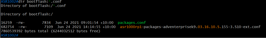

  1. Check the contents of the bootflash and compare the date stamp of the extracted packages against the date stamp of the “packages.conf” file (see image below).
  1. Look in the bootflash directory for two (2) files with an extension of “conf”.  (Image below)

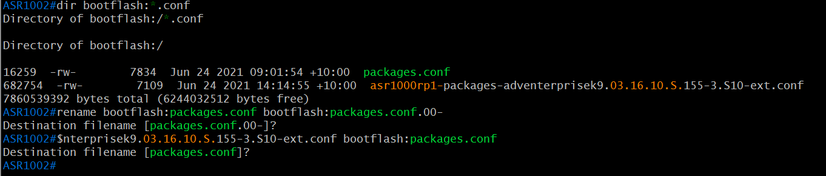

  1. First, rename “packages.conf” to, say, “packages.conf.00-“.
  2. Next, rename the firmware.conf to “packages.conf” (see below).

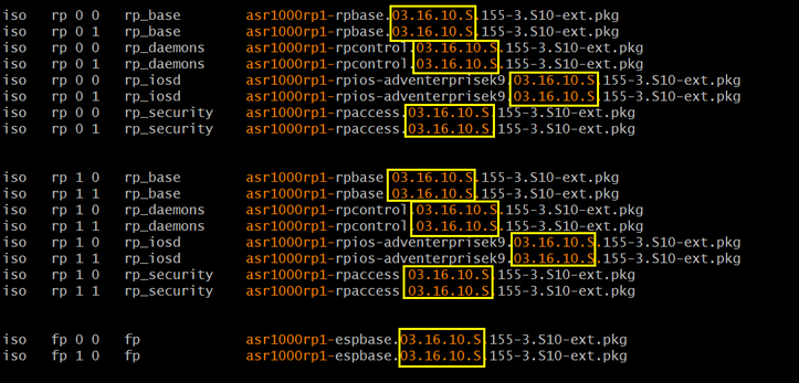

  1. Check the contents of the new “packages.conf” file (see below).
