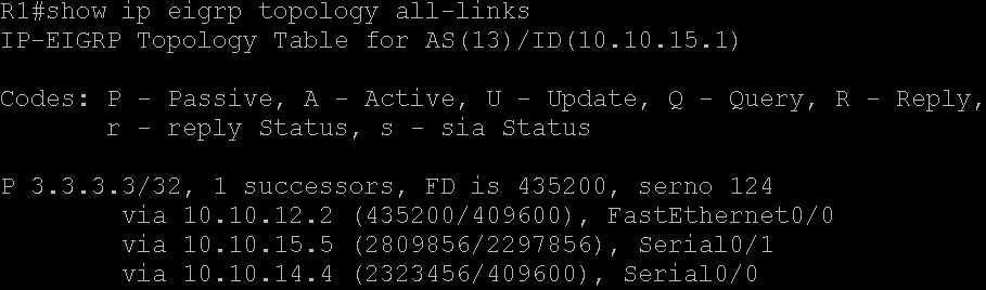

    As we desire, EIGRP with load balancing functionality, the route 3.3.3.3/32 should be available with R1 via R4 and R5. We verify the minimum and the maximum cost to reach 3.3.3.3 network from R1 via command "show ip eigrp topology all-links". R1 from its EIGRP topology table is learning the route 3.3.3.3/32 from all the sources but installed the route learned via neighbour R2 in its routing table.
    The lowest metric is 435200 (that of path R1-R2-R3) and the maximum 2809856 (that of path R1-R5-R3).

    Doing a small calculation to find the variance number, 2809856/435200 = 6.4567. I wil use a variance value of 7. Now 7*435200 = 3046400, routes with metric less than this value should be included.

    For R1 and R4
    1. If, for a destination (3.3.3.3), a neighbour router (R4) advertises a distance (409600) that is stricktly lower than our feasible distance (435200), then this neighbour lies on a loop free route to this destination.
    2. Metric learned from R4 (2323456) < Metric Calculated via Variance Multiplier (3046400)
    For R1 and R5,  this condition is not met as R5 advertises a distance 2297856 which is much higher that the feasible distance (435200) on R1.
    Note: Even though the overall metric from R5 (2323456) is less than the Metric Calculated via Variance Multiplier (3046400), the route 3.3.3.3 is discarded as it does not meet the Feasibility Condition.
