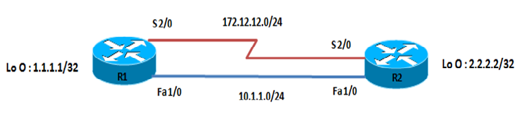

    In this network topology, two routers R1 & R2 are connected via Fast Ethernet (Fa 1/0) and Serial (Se 2/0) interfaces. OSPF is the routing protocol configured and networks advertised are the loopback addresses of the two routers (Prefix 1.1.1.1/32 and 2.2.2.2/32).

    Topology Diagram

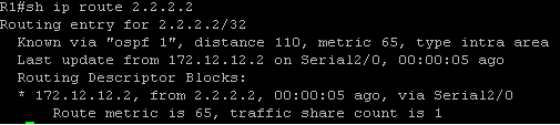

    Verification
    Note: The prefix 2.2.2.2 is known via Serial 2/0 Interface with a metric of 65.
