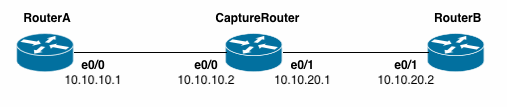

Topology
The topology for the exercise is:
IP addresses are:
RouterA Ethernet 0/0: 10.10.10.1/255.255.255.0
CaptureRouter Ethernet 0/0: 10.10.10.2/255.255.255.0
CaptureRouter Ethernet 1/0: 10.10.20.1/255.255.255.0
RouterB Ethernet 1/0: 10.10.20.2/255.255.255.0
