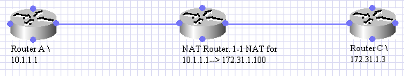

Objective:
Configuring IPSec VPN between IOS Router and any Remote VPN Peer
Symptom:
Phase 1 Completes but Phase 2 is failing with the below error
: ISAKMP:(1002): IPSec policy invalidated proposal with error 32
: ISAKMP:(1002): phase 2 SA policy not acceptable! (local X.X.1.3 remote X.X.1.100)
: ISAKMP: set new node -1593419981 to QM_IDLE
: ISAKMP:(1002):Sending NOTIFY PROPOSAL_NOT_CHOSEN protocol 3
Topology:
Current Crypto Configuration:
Some parts of Relevant Crypto Config on Router C
Router C:
crypto isakmp profile RouterA
   keyring All

Solution:
The problem here is that the Crypto Map is referencing the ISAKMP Profile "RouterA", which means that during Phase1 the Remote Router should match the ISAKMP Profile.
A common mistake is that while defining the "match" statement in the ISAKMP Profile the POST-NAT address of the Remote Peer is used and the ISAKMP profile never gets matched as seen above. This results in Phase2 failure with error 32.
This can be fixed in two ways
Option 1:
Remove the ISAKMP profile reference from the Crypto Map, however this is probably not the best approach. The ISAKMP profiles provide great flexibility therefore Option 2 as below is a better option.
Option 2:
A. Modify the "match.." statement in the ISAKMP profile to match the address as being sent by the Remote peer. As seen from the above debugs , this address is 10.1.1.1. So the below config will fix the problem
   no match identity address 172.31.1.100 255.255.255.255
   match identity address 10.1.1.1 255.255.255.255
B. However the above solution can represent a problem, when the Remote Peer has a DHCP assigned address. In this case a better approach can be to configure the Remote Router to send its hostname as the ISAKMP Identity instead of "IP Address".
On Cisco devices this can be configured as
crypto isakmp identity hostname
Modify "Router C" config as below
   match identity host RouterA
The above will fix the problem and the solution will keep working even if RouterA's WAN IP changes.
