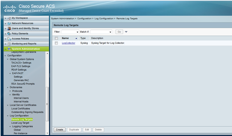

    Step 1: Click on Remote Log target under log configuration then click on Create button to define the external syslog server.
    Step 2: Define the Name of external syslog server and the IP address of the same, you can also mention the port number.
    Note: By default the port number is 514
     You will see that the external syslog server is created:

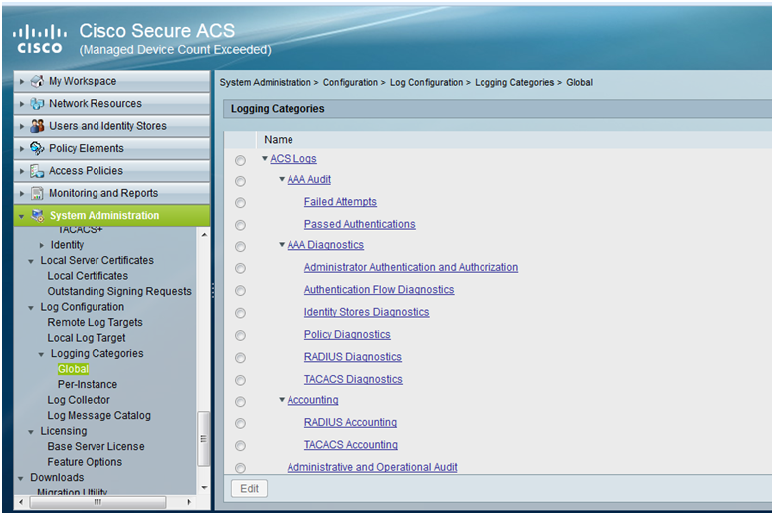

    Step 3: Now click on Global configuration under the system administration
    Step 4: select the logging category for which you want to send the logs to the external syslog server.

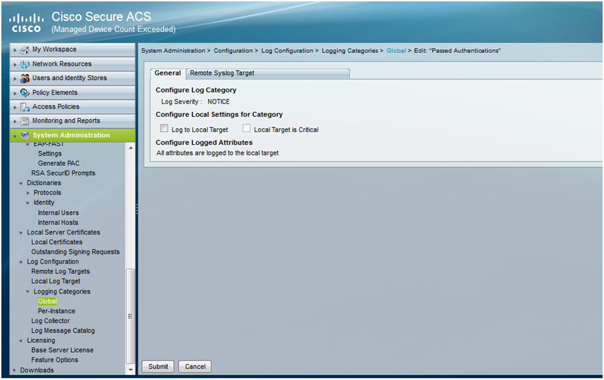

    For example here I want to send all the passed authentication logs to external syslog server.

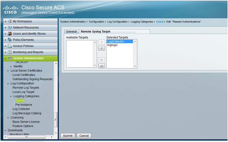

    Step 5: Now select the Remote Syslog Target Tab
    Step 6: Move the configured syslog server to the selected target and then click on submit.
