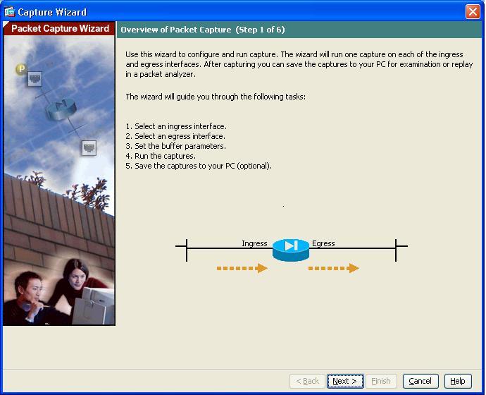

    Enable captures on ASDM
    Go to wizards and select packet capture wizard, it will take you through 6 simple self explanatory steps, once done with captures select save captures. This has been illustrated in Scenario 1

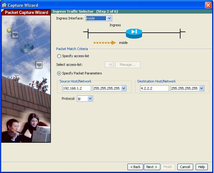

    So here we nat all users to interface ip
    Commands to capture traffic
    Inside:
    access-list capi extended permit ip host 192.168.1.2 host 4.2.2.2
    access-list capi extended permit ip host 4.2.2.2 host 192.168.1.2
    capture capin interface inside access-list capi
    Or
    capture capin interface inside match ip host 192.168.1.2 host 4.2.2.2
    [this is possible in asa 8.0 and above and we do not need to be in config mode to put apply an capture]

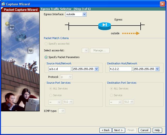

    Outside:
    access-list capo extended permit ip host a.b.c.d host 4.2.2.2
    access-list capo extended permit ip host 4.2.2.2 host a.b.c.d
    capture capout interface outside access-list capo
    Or
    capture capout interface outside match ip host a.b.c.d host 4.2.2.2
    [Note that we are using the natted ip - so for capture  use the ip addresses that you expect to see on the wire after all  processing is done for egress interface and before any processing is  done for ingress interface]
    We can also apply capture using ASDM and the below screen shots show the steps for that
    Overview Step1.JPGSelect Ingress Traffic Step2.JPGSelect Egress Interface Step3.JPGBuffers and Capture Parameters Step4.JPGSummary Step5.JPGStarting Captures Step6.JPG
