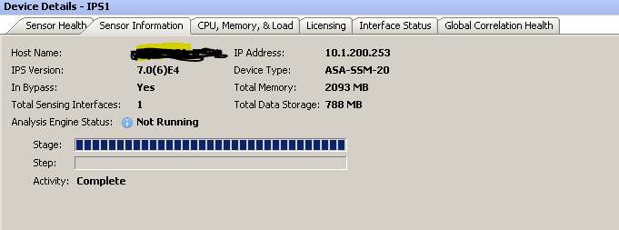

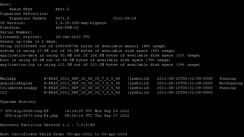

Problem
IPS connected with ASA is not able to inspect the traffic and signature update gets failed.
Solution
All sensors should have a virtual sensor assigned to them so they can inspect traffic.
Run the following commands to assign the virtual sensor
service analysis-engine
virtual-sensor vs0
physical-interface gi0/1
From the ASA
"do sh service-policy" and determine how many packets are being exchanged between the IPS and the ASA
