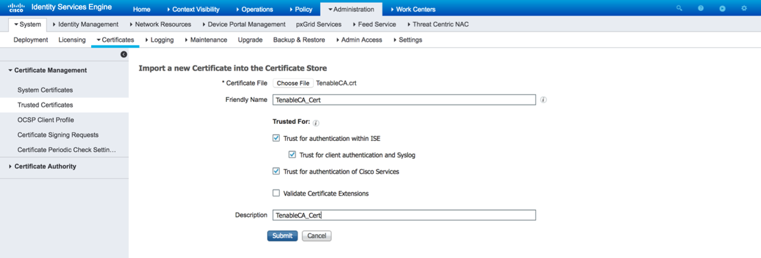

Browse to Administration > Certificates > Trusted Certificates. Select Import.
Repeat this procedure for the Security Center certificate.

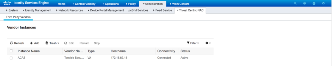

Under the Vendor Instances screen you should now see the newly configured Tenable Adapter is connected and active.

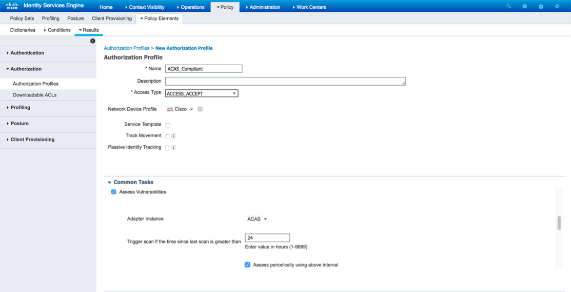

Name the Authorization profile. Under Common Tasks select Assess Vulnerabilities. From the Adapter Instance drop down select the previously configured Tenable Adapter instance. Configure the Trigger scan time in hours and click submit.

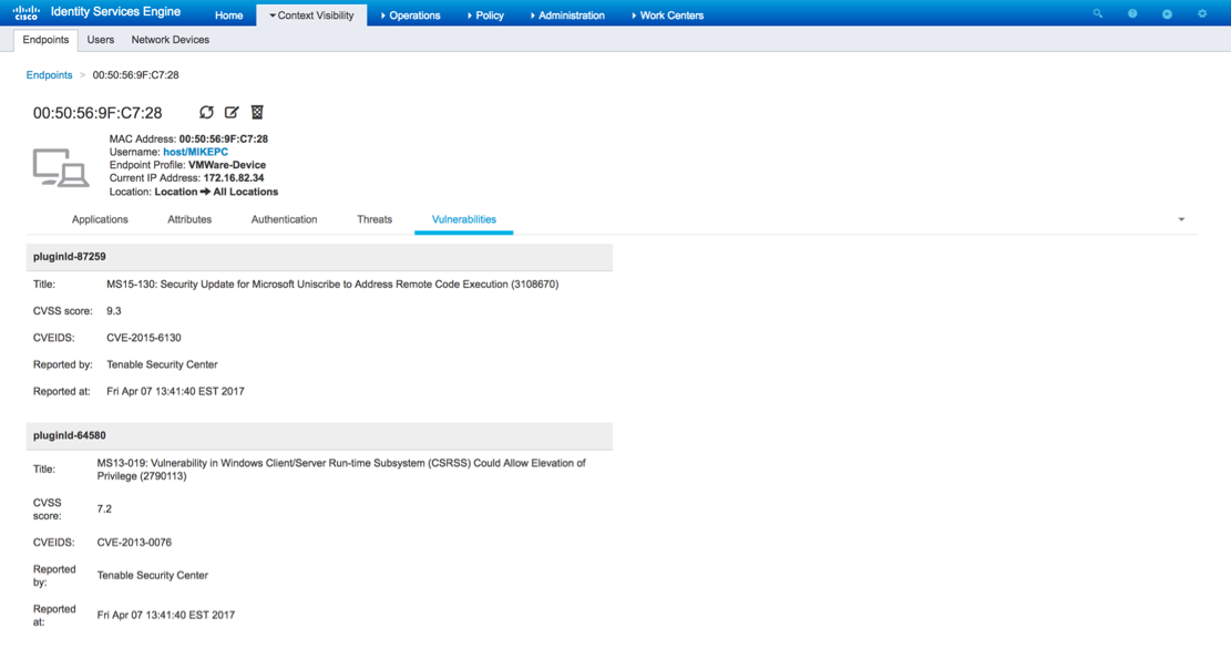

In order to verify which vulnerabilities were detected, navigate to Context Visibility > Endpoints > Vulnerable Endpoints. Check per endpoint Vulnerabilities with the Scores given to it by Security Center.
When selecting a particular endpoint, by clicking on the MAC address, more details about each Vulnerability appears, including PluginID, Title, CVSS Score, and CVEID's.

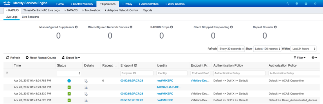

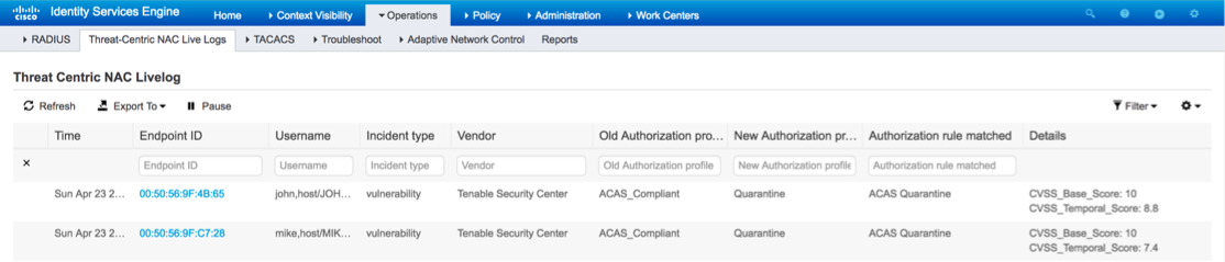

In Operations > TC-NAC Live Logs, you can see Old vs New authorization policies applied and details on CVSS_Base_Score. Note: Authorization conditions are done based on CVSS_Base_Score, which equals to the highest Vulnerability Score detected on the endpoint.

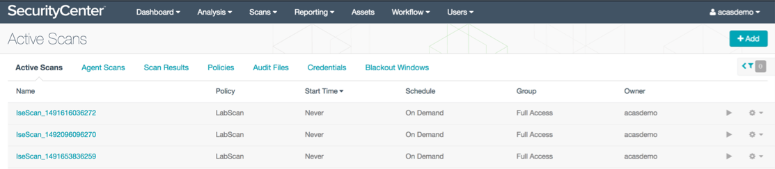

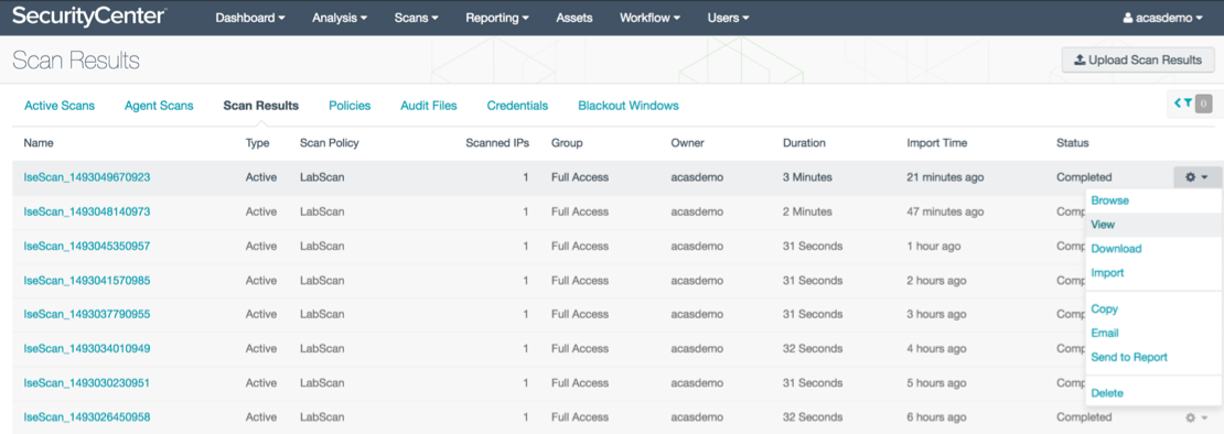

When the VA Scan is triggered by TC-NAC Tenable.sc queues the Scan, it can be viewed at Scans > Active Scans.

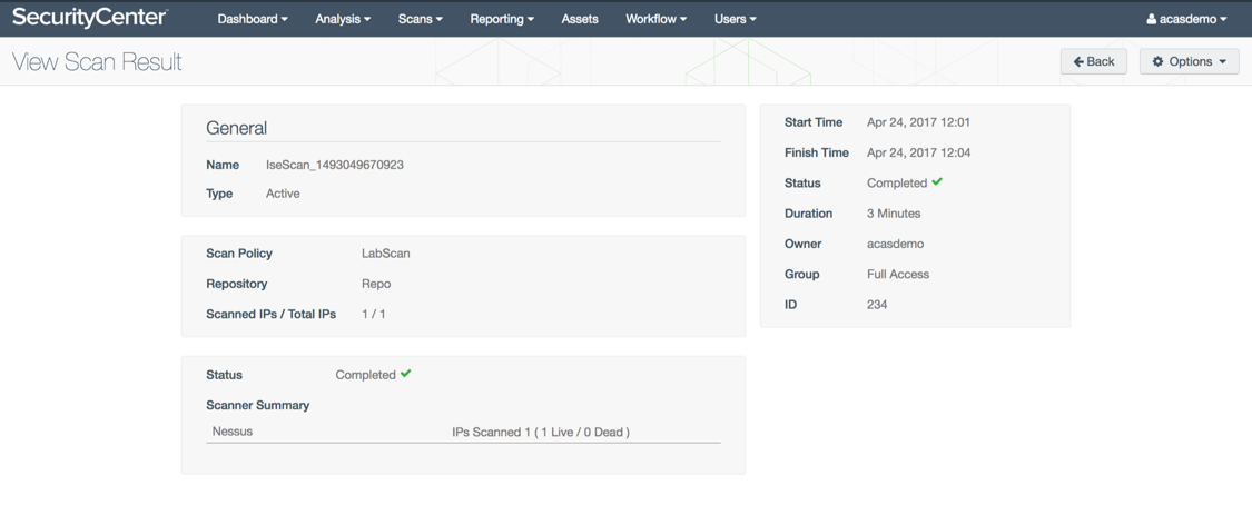

Once the scan completes it can be viewed under Scans > Scan Results.

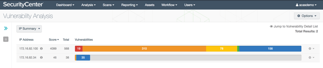

Navigate to the Analysis > Vulnerabilities page. From the drop-down menu select IP summary. This will give you a summary of all of the IP addresses that have vulnerabilities.
Click on one of the IP addresses for a detailed list of exact vulnerabilities. Note that you can also view these vulnerabilities from Cisco ISE under Context Visibility > Endpoints > Vulnerable Endpoints.
