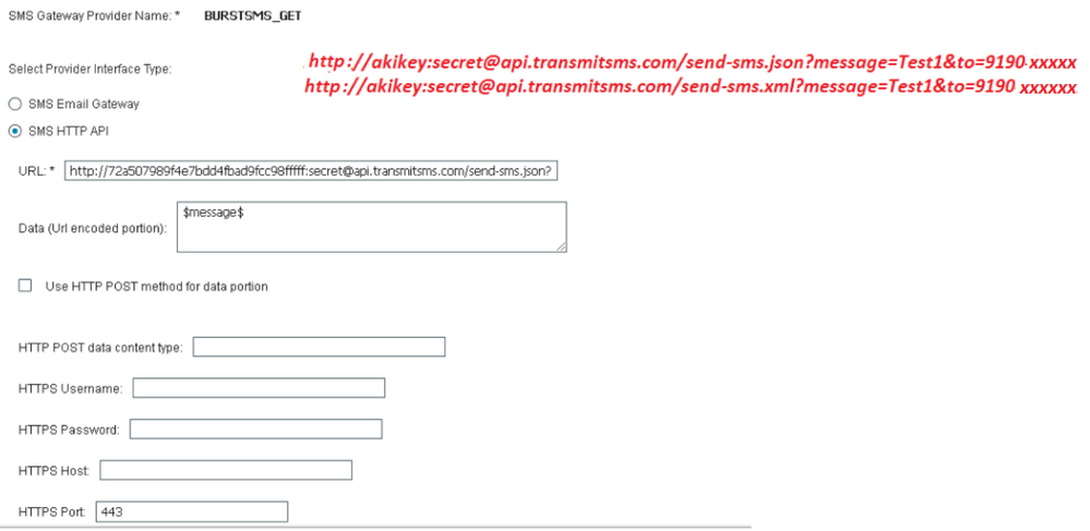

ISE Configuration Example with HTTP GET
  1. Navigate to Administration > System > Settings > SMS Gateway
  2. The only line you need to configure is the URL line. Disregard the other fields that are automatically updated.
    https://akikey:secret@api.transmitsms.com/2/send-sms.json?message=$message$&to=$mobilenumber$

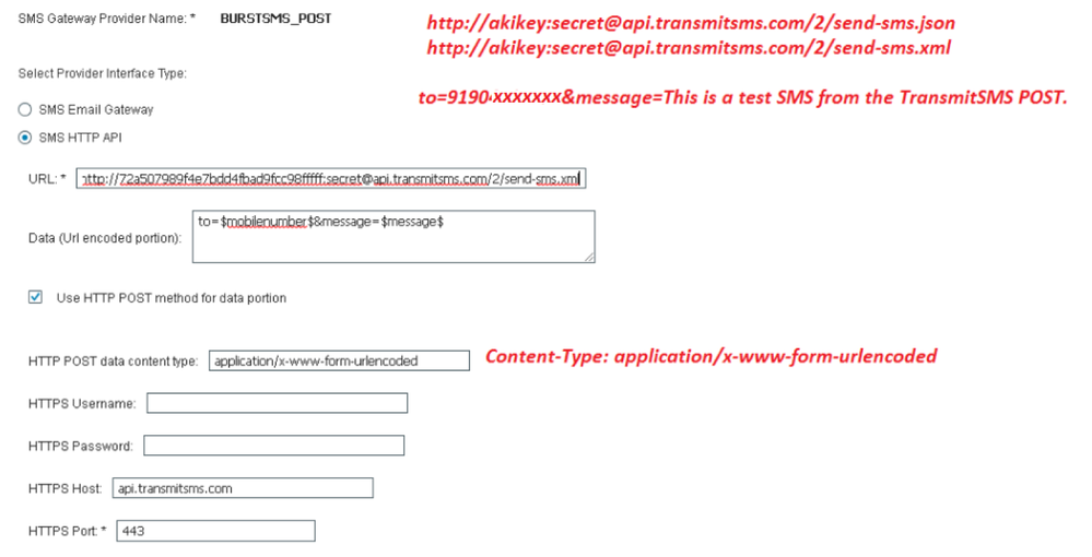

ISE Configuration Example with HTTP POST
  1. Navigate to Administration > System > Settings > SMS Gateway > Add
  2. You need to configure the URL line with content type.
