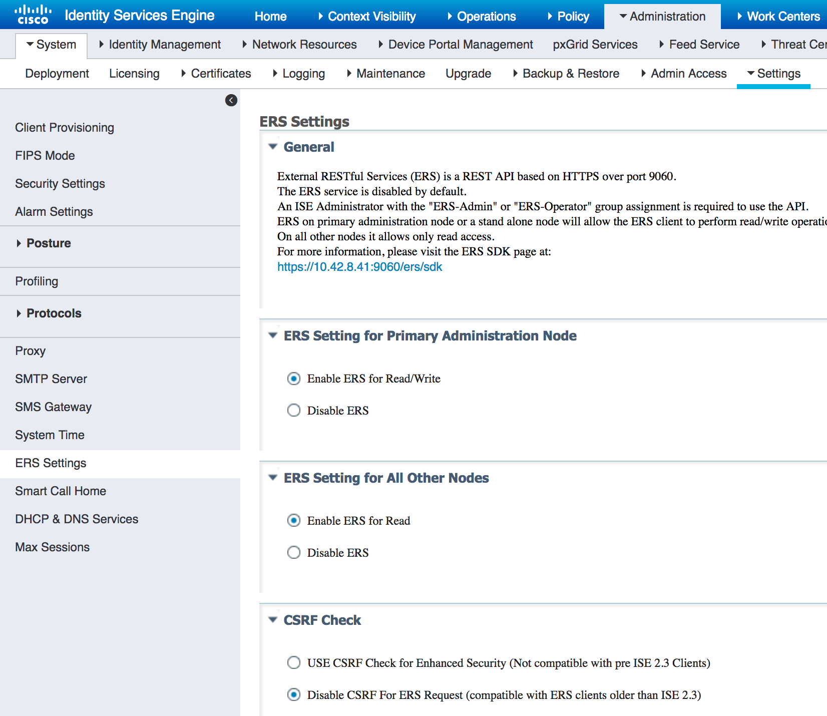

  1. In ISE, navigtat to Administration > System > Settings > ERS Settings
  2. Check Enable ERS for Read/Write
  3. You may optionally check Enable ERS for Read if you will be doing REST APIs actions beyond the guest functions
  4. Disable CSRF
  5. Save the settings

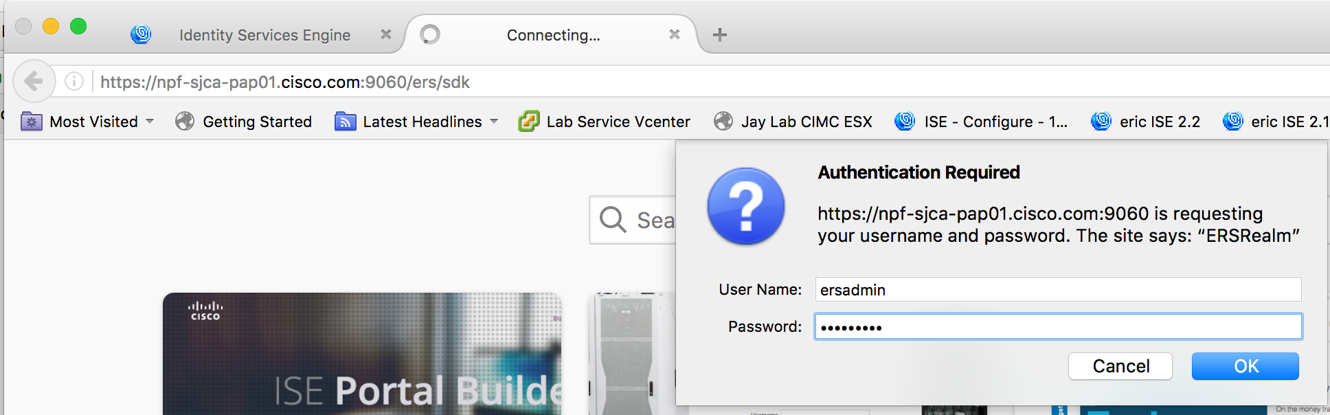

  6. You should now be able to login to the SDK using the link https://YOUR-PAN-NAME:9060/ers/sdk :

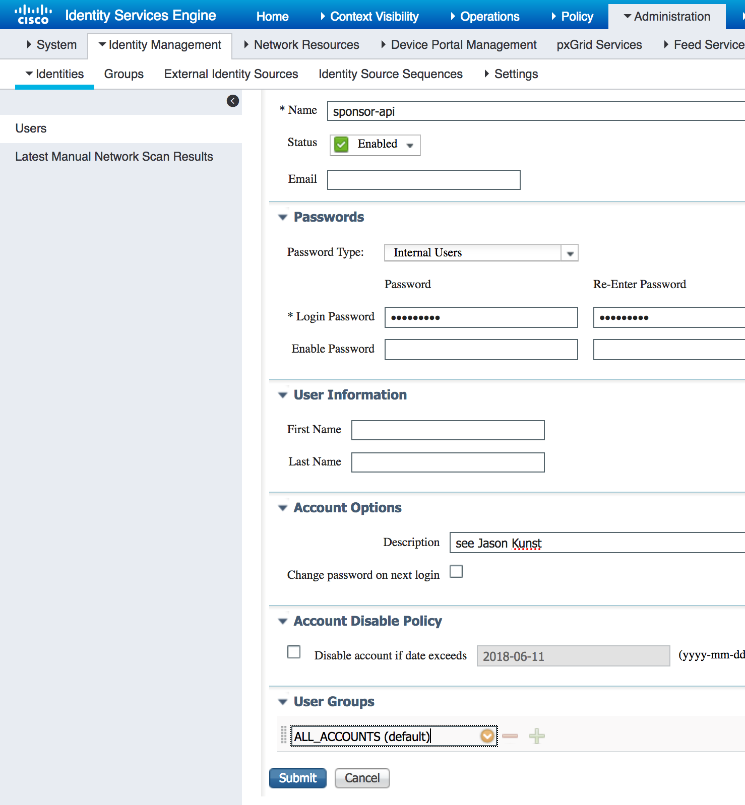

  1. In ISE, go to Administration > Identity Management > Identities > Users
  2. Click +Add to add a new sponsor-api user for ALL_ACCOUNTS :
    This sponsor will have visibility of ALL Guests in the system.  If you wanted to limit it then you could use different group.
  3. Click on Submit to save the new account
