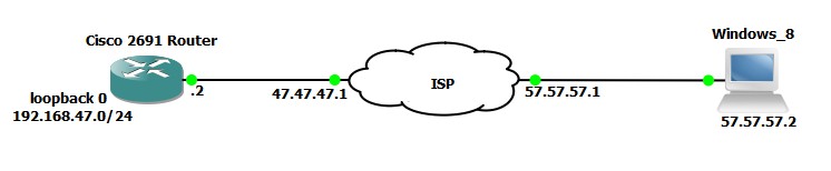

Diagram:

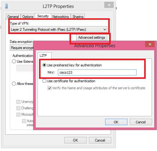

7. Right click on the connection entry and click on properties:
8. Make sure the IP      address or the FQDN is correct in the General tab:
9. In the Security      tab, make sure type of VPN is “L2TP/IPSEC”. Then Click on advance settings      and add pre-share key:
10. Then select “Allow these protocol” and make sure MS-CHAP v2 is selected:

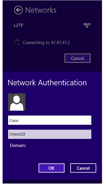

11. To connect,  left click on the network icon in the task bar:
12. You will see the following, type in your user name and      password and click on OK:
13. If everything is good you will see the following screen:

nbg
Community Member
IMPORTANT ERROR FIX:
in step 12, in the credentials boxes I had to type username: cisco and password: cisco in order the connection to succeed (and not Cisco, Cisco123).
