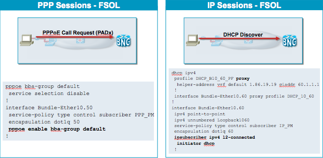

This is the basic configuration to be setup in order to get PPPoE and IP sessions running.
Note that PPP and IPoE sessions can co-exist on the same parent interface as well as on the same subinterface.
This this is a base configuration example to setup the FSOL handling for PPPoE or IP sessions.

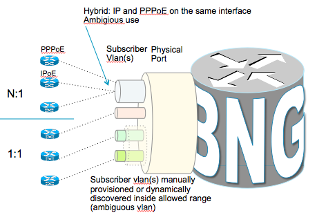

Using ambigious vlans
Originally for double tagged traffic, also known is QinQ or QiQ, we had to explicitly configure the inner and outer vlan combination for each possible termination point. In ASR9000/XR we can define ambigious ranges allowing us to specify the outer vlan only and an inner range.
The most common deployment scenario for QIQ is whereby the outer vlan represents the dslam and the inner vlan represents the subscriber, obviously configuring 64k subinterfaces is not very easy to manage and the Ambigious vlan support greatly reduces operational overhead, large configs and provides for much more simplicity:
Configuration example:
interface Bundle-Ether1.50
service-policy type control subscriber PPP_IP_PM1
pppoe enable bba-group default
encapsulation ambiguous    dot1q { any | <vlan range> }
                           dot1ad { any | <vlan range> }
                           dot1q <vlan#> second-dot1q { any | <vlan range> }
                           dot1ad <vlan#> second-dot1q { any | <vlan range> }

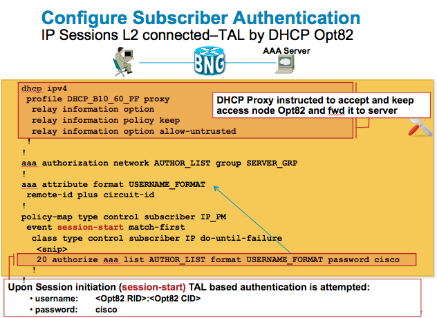

Example TAL (Transparent Autologon) use case 1
TAL or transparent autologon is one of the most commonly used access scenarios for IP sessions.
You can authenticate the user on mac address or option 82 information. The following use cases depict on how to set that up with the ASR9000 BNG implementation.

    One key action in the control policy is obviously the authentication.
    These can be executed via the command under the event/class:
    • 10 authorize aaa list default identifier source-address-mac password cisco
    • 10 authenticate aaa list default
    Both of these will trigger a RADIUS access-request message, but the difference between the two is with the authorize statement we can compose the username ourselves regardless of what is received on the line, where as the authenticate statement uses the PPP chap or pap username and password received. The authenticate option for that reason only applies to PPP based sessions.
    You can define the username in the authorize statement either inline as per example above or you can construct the username via a "formatted" way:
    Note that an authentication does NOT have to succeed in order for BNG to bring up the session.
    The activation of a dynamic template will create the subscriber interface regardless of the authentication result.
    A failed authentication will result in an unauthenticated state and you'll be able to apply HTTP-redirect or restricted access on the session.

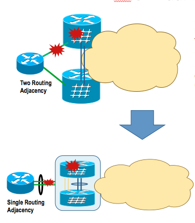

    Cluster
    Cluster is the concept of binding two physical chassis together into 1 logical unit. The control plane is extended via RSP on board 1 or 10G interfaces while the data plane is extended via 1 or more physical interfaces on the linecards.
    So when building a bundle from the access side, if you link them to each individual chassis you'll have an active active bundle with failover between chassis!
    Also the physical ASR's don't need to be on the same location. Only the control plane extension needs to have minimum latency (~<20msec).

    This is critical, because our access equipment (DSLAMs) won't be able to insert DHCP opt82 equivalent for IPv6,
    and we don't want to authorize subscriber's MACs as they can be changing often.
    Can You please confirm, that outer-vlan-id, inner-vlan-id are indeed there, and 1:1
    vlan with ambiguous does indeed make sence for dual-stack in 4.3.0?

    Yes you can do that:
    aaa attribute format USERNAME_FORMAT_SUPER_FLEXIBLE
    format-string "%s*%s-mystring" ?
      inner-vlan-id            Inner VLAN ID needed to form NAS Port
      outer-vlan-id            Outer VLAN ID needed to form NAS Port
    Note however that the 2 stacks are not authenticated independently.
    once the first AF comes up, radius is consulted, and will provide all the data for both stacks back.
    Then when the 2nd AF comes up, the previous (unused) author data will get applied/used.

    For 2 stacks, I assume that BNG will key on MAC, and if say IPv4 came first, it's (s-vlan;c-vlan) was authorized, and subequent traffic from that MAC, no matter, IPv4 or IPv6, is threated as single session, is it correct?
    If so, it also automatically applies to all the traffic from IPv6 prefix delegated to customer, right?
    Also, does 9k have somthing similar (or better) to IP Subnet Session on 1k or SIP-400?
    xthuijs
    correct: MAC is the primary key.
