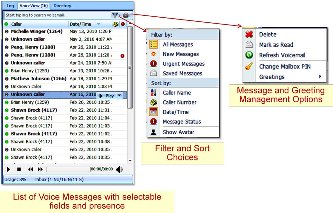

From the VoiceView window, users can:
  • View the number of messages waiting and the voice message popup notification
  • View the new and saved voice messages in the UC500 (Cisco Unity Express - CUE) mailbox
  • Play, pause, rewind, move, forward, and delete voice messages
  • View the caller’s name and presence status (if available)
  • Change the voice message greeting
