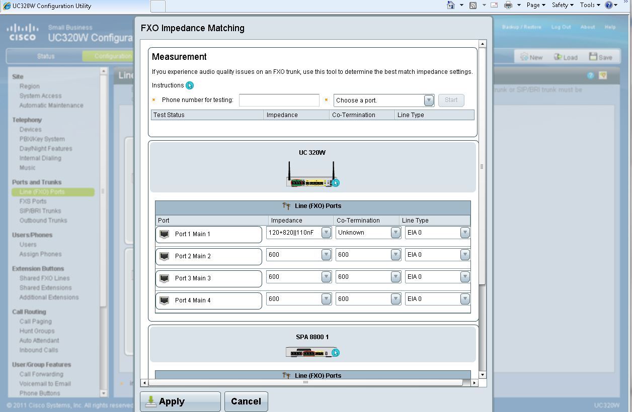

  • Run Impedance Matching Tool on each installed FXO Line (see screenshot below).
    • Try to call a phone that is on the same Central Office as the UC320W.
    • If possible, call a digital phone.
    • Be sure to mute the microphone at the called phone during the test.
  • Set the the "Impedance", "CO-Termination" and "Line Type" Variable settings recommended by the tool on each FXO port.
  • If after running the Impedance Matching Tool you are still experiencing echo, then adjust the GAIN on the FXO port.
    • If results don't improve, you might need open a trouble ticket with the Service Provider.
    FXO Impedance Matching Tool Screenshot

            • Ensure you have run the FXO Impedence Matching on each FXO (see screenshot  above).

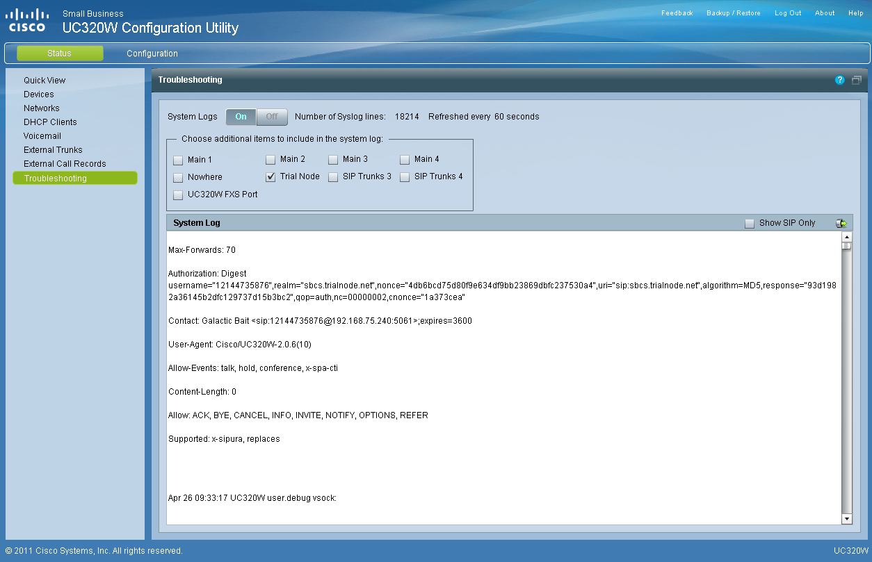

              • Enable trace on your SIP trunk on the UC320W Configuration Utility's Status/Troubleshooting. (see screenshot below ... Alternatively you can capture packets on the WAN Interface using a network sniffer).
              • Reset your UC320W and look for your Registration message looking to see if the Registration is sent and possibly rejected.  See if the reject reason helps understand the issue to be corrected.
            • If you are using a SIP Service Provider that might not be certified with the UC320W system, it might be necessary to assist with the SIP Service Provider Certification process in ensure all possible interoperability issues are addressed.
            UC320W Status - Troubleshooting Interface Screenshot
            (click image to enlarge)

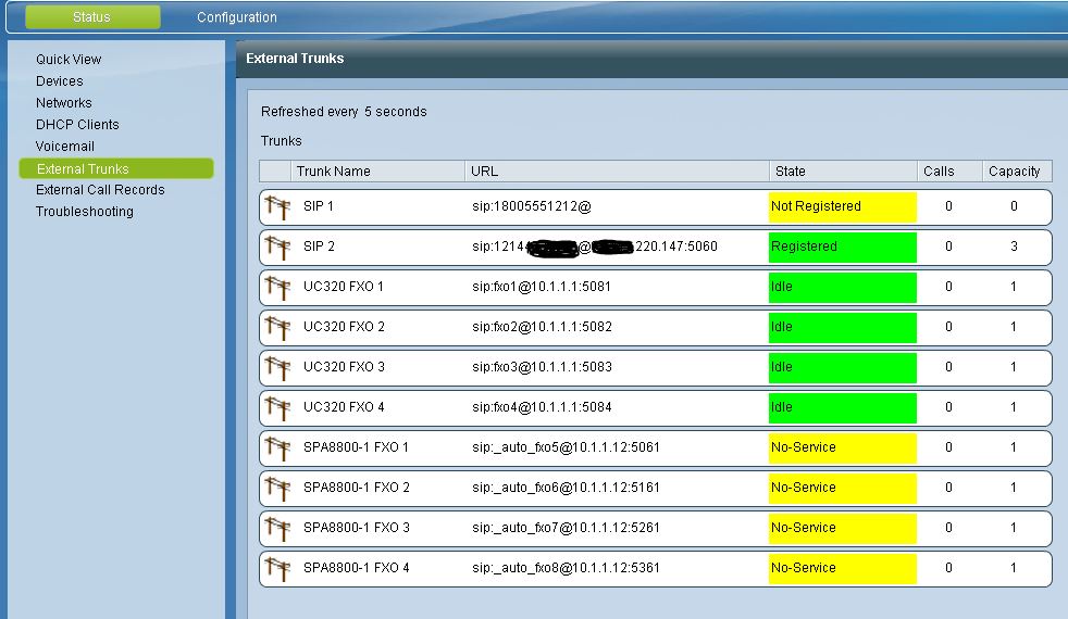

              UC320W Status - External Trunk Interface Screenshot

              • Enable  trace on your SIP trunk on the UC320W Configuration Utility's  Status -> Troubleshooting (Support Tools). (Alternatively you can capture packets on the  WAN Interface using a network sniffer).
