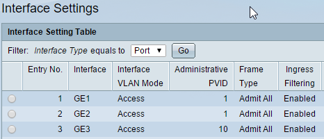

We have just purchased a SG300-51 switch to enable our business to grow. I am attempting to setup 2 vlans (1 containing a router, the second just my pc for now whilst i test it).
  • vlan 1 (the default) obviously works fine with access to the internet.
  • vlan 2 (which is on vlan id 10) has no access to the internet.
For note, our router is managed so I have no control over this.
So for now Ports 1 - 2 are on vlan 1 under Access. Port 3 is under vlan 2 under access. I have switched port 3 to trunk but to no avail. All traffic is marked as untagged on all ports.

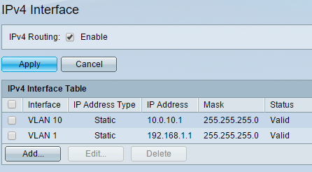

IP's assigned on vlan 1 are assigned from the router starting at 192.168.1.1 to x.x.1.254 (the router is at 254). The switch for vlan 1 is at 192.168.1.1.

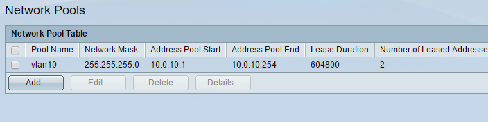

IP's assigned in vlan 2 (by on board dhcp on the switch) are 10.0.10.1 - 10.0.10.254 (the switch setup to be 10.0.10.1).
I have a IPv4 static route of: 0.0.0.0 to 192.168.1.254.

I could be wrong, but I think he must already be in L3 mode since it appears he was able to assign interface IP addresses to both VLAN 1 and 10.
If your PC is plugged into gi3 on access vlan 10 then you need to use 10.0.10.1 as your default gateway and in your router/firewall you need a return route to 10.0.10.0/24 via 192.168.1.1

For intervlan routing and multiple layer 3 vlans the switch needs to be set in L3 mode , out of the box it comes as L2 , have you tried that yet ?
http://www.cisco.com/c/dam/en/us/td/docs/switches/lan/csbms/sf30x_sg30x/administration_guide/78-19308-01.pdf
Thank you for responding :). Yes it is in L3 mode (first thing i did).
I have read somewhere about assigning the switch a default-gateway however I can't see it in the web UI anywhere, would this make a difference?
any update on this?
i had to use the cli for gateway settings on my sg500's, assuming your gateway is also handling external DNS (and ensure you backup config first!)
yourSwitch#configure terminal
yourSwitch(config)#ip default-gateway 192.168.1.254
yourSwitch(config)#ip name-server 192.168.1.254
yourSwitch(config)#ip routing
yourSwitch(config)#exit
yourSwitch#copy running-config startup-config
ip routing is a vital step. probably going to need a reboot!

Having just had a chance to work on this, it doesn't seem to make a difference.
It does look like the route back on the router is the key issue here.
Just for reference, the second vlan is now at 192.168.2.1 with a route to 0.0.0.0 and this is set to route to 192.168.1.254.
I will need to look at getting a router we control so that i can bridge it with the ISP controlled router.

I can't think of any way around this.  The ISP router will need a return route to be able to get back to your 10.0.10.0/24 network.  I suppose a more advanced L3 switch using a routing protocol might work if the ISP router could be set to use the routing protocol, but realistically what I would recommend is to use your own firewall/router and the ISP put their box in bridged mode.  This way you have full control of your network.

Just so that you know (and after a loong time) a RV320 router in bridged mode with the correct static routes works a treat.
There is a speed issue I am dealing with but that is something that i can deal with.
Thanks all for your help and sorry it has taken so long to mark the correct answer.
