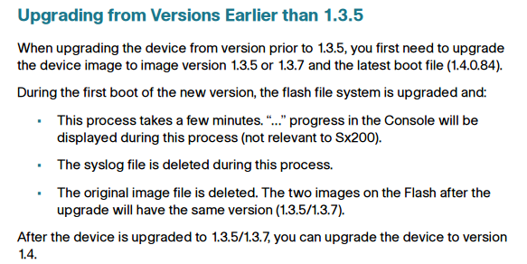

Hi everyone
Hoping for some clarification, searching hasn't revealed anything clearly defined.
As titled, 3 SG500 switches in a stack (running in L3 mode), firmware info below
Firmware Version (Active Image): 1.3.5.58
Firmware Version (Non-active): 1.2.7.76
Boot Version: 1.2.0.12
I've read upgrading past v 1.3.5.58 is a no-go without upgrading the boot version. Will I need to downgrade active FW all the way back to  1.2.0.12, then upgrade Boot to 1.2.7.76, then re-upgrade FW to 1.2.7.76 and so-on and so on through each Boot/ FW [1.2.0.97, 1.2.7.76, 1.2.9.44, 1.3.0.59, 1.3.0.62, 1.3.5.58, 1.3.5.58, 1.3.7.18, 1.4.0.88]?
I'll take a backup of running config prior obviously, but  will my settings survive this?
Thanks for the input, I'd really like to not brick these switches!

Firmware 1.4 Release Note:
http://www.cisco.com/c/dam/en/us/td/docs/switches/lan/csbms/Sx500/release_notes/R_1_4_RN.pdf

Update - after re-reading the Cisco support documents and focusing on the section containing the Answer above. I backed up the running config (took some notes - just-in-case), upgraded the boot image to the version included in the 1.3.5.58 firmware download and rebooted the stack.
I then stepped though the 1.4.0.88 boot image upgrade, rebooted (to be sure), upgraded firmware, set active image and rebooted. All appears well. Thanks for the input!
1.4.0.88
1.3.5.58
1.4.0.02
