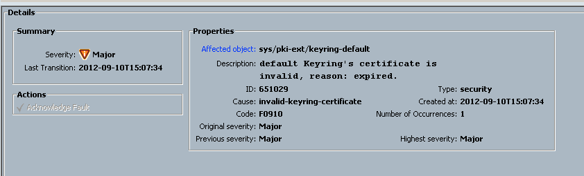

I'm upgrading my UCS to version 2.0.3c, and everything is working fine.
But when I upgraded the first FI, I got this Major Fault:
I don't dare to upgrade the second FI, before I fix this error.
I have seen that this certificate has to do with secure connection between Client Browser and UCSM.
I haven't made any certificate when the UCS was set up (because there where some consultant that sat up the solution).
What to I need to do?

Since you haven't done anything to the cert since installation, all you need to do is regenerate the default key ring.
Refer to this document, under "Regenerating the Default Keyring":
http://www.cisco.com/en/US/docs/unified_computing/ucs/sw/cli/config/guide/2.0/b_UCSM_CLI_Configuration_Guide_2_0_chapter_0110.pdf

Thanks for quick response
So all I have to do is ?:
Step 1 UCS-A# scope security
Step 2 UCS-A /security # scope keyring default
Step 3 UCS-A /security/keyring # set regenerate yes
Step 4 UCS-A /security/keyring # commit-buffer
This will not create any issues?
That would be correct
Then I will try it.
I only need to do this once? Not on both FI?
You only need to do this on the active FI, not both, no.
Thanks Glenn
It did the trick
