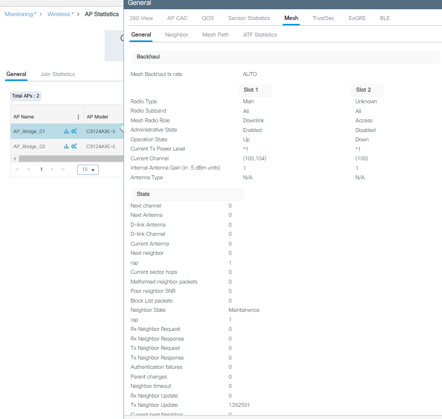

The problem is that when I disconnect C9124_B from the ethernet, I cannot reach the AP over the bridge. These APs do not see each other as mesh neighbors.
i see AP_Bridge_01 is using channels 100,104
but the log of the AP_Bridge_02 shows:
     *06/02/2023 12:29:56.0038] DOT11_DRV[0]: Channel set to 2
     [*06/02/2023 12:32:28.6689] DOT11_DRV[0]: Channel set to 12
for 2.4 GHz band. and
     [*06/02/2023 12:32:26.7338] DOT11_DRV[1]: Channel set to 136
for 5GHz band
=> configure matching channels
