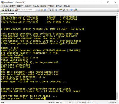

AP启动不了了,接cli会卡死在load的时候
按网上的教程按住mode键通电开机,提示是下面这样的
如果不按esc取消还是会变成正常启动
固件是官网下的AIR-AP1850-K9-8-10-151-0.tar
Button is pressed. Configuration reset activated..
Keep the button pressed for > 20 seconds for full reset
Wait for the button to be released ....
Button pressed for 47 seconds
Setting env for full reset..
Writing to SPI Flash...
Erasing block 0x1c0000
Erasing at 0x1c7000 -- 100% complete.
done
Signature returns 0
BL signing verification success, continue to run...
Auto boot mode, use bootipq directly
Hit ESC key to stop autoboot: 0
如果让他自己启动最后就会卡死在下面这个部分
[*02/27/2021 16:54:26.9975] pid 2464's current affinity mask: 3
[*02/27/2021 16:54:26.9975] pid 2464's new affinity mask: 1
[*02/27/2021 16:54:29.4967]
[*02/27/2021 16:54:29.4967] Click sched monitor: schedulers = 1
[02/27/2021 16:54:40.1534] L2 Error detected!
[02/27/2021 16:54:40.1934] L2ESR = 0x00010001
[02/27/2021 16:54:40.2434] L2ESYNR0 = 0x7e008653
[02/27/2021 16:54:40.2933] L2ESYNR1 = 0x02c478f9
[02/27/2021 16:54:40.3533] L2EAR0 = 0x7efe8a5b
[02/27/2021 16:54:40.4033] L2EAR1 = 0x00000004
[02/27/2021 16:54:40.4533] CPU bitmap = 0x1
