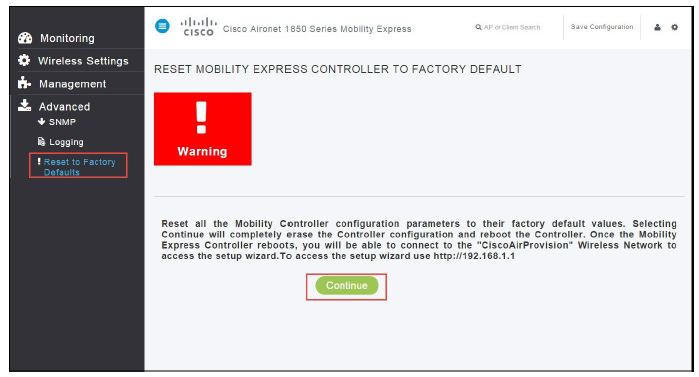

步骤 1 点击高级> 重置为出厂默认设置。
将Mobility Express 控制器重置为出厂默认设置页面即会显示。
步骤 2 点击继续。

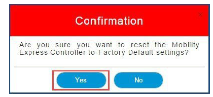

确认消息对话框即会显示。
步骤 3 点击是。 即可恢复配置。

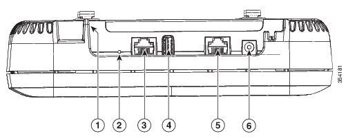

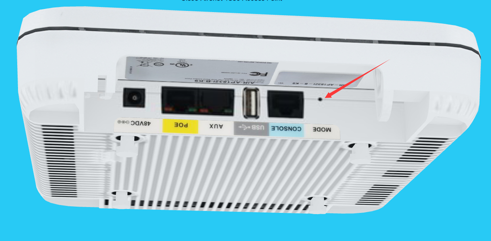

就在我想通过web 去登陆的时候发现我配置机器的时候是随便写了一个IP 地址,然而我电脑的IP是内网IP ,跟ME AP 不是一个网段,但是没有独立电源又无法拔掉Poe直接对接我笔记本。 这时候会说通过CLI 修改IP 啊, 不过尴尬的是当时我竟然忘记了命令,还没好到我的笔记。 看着AP的接口,突然看到mode 按钮
如图中2点,这个时候想起来了,其实通过Mode按钮是可以恢复出厂值的,具体操作如下:
Using the Mode Button
Using the Mode button (see Figure 2) you can:
  • Reset the AP to its default factory-shipped configuration.
  • Clear the AP’s internal storage, including all configuration files and the regulatory domain configuration.
To use the mode button, press, and keep pressed, the mode button on the access point during the AP's boot cycle. Wait until the AP's status LED changes to Amber. During this, the AP console shows a seconds counter, counting the number of seconds the mode button is pressed. Then:
  • To reset the AP to its default factory-shipped configuration, keep the mode button pressed for less than 20 seconds. The AP's configuration files are cleared.
This resets all configuration settings to factory defaults, including passwords, WEP keys, the IP address, and the SSID. However, the regulatory domain provisioning is not reset.
  • To clear the AP’s internal storage, including all configuration files and the regulatory domain configuration, keep the mode button pressed for more than 20 seconds, but less than 60 seconds.
The AP's status LED changes from Amber to Red, and all the files in the AP's storage directory are cleared. This also removes any regulatory domain provisioning made previously and resets the AP back to -UX domain.
If you keep the mode button pressed for more than 60 seconds, the mode button is assumed faulty and no changes are made.
恢复出厂值后可以安心的将AP 交给销售了;P
也算给大家一个提示: 如果有心朋友不太熟悉命令行,或者忘记了设备的登录信息,通过mode按钮恢复出厂值很方便!
