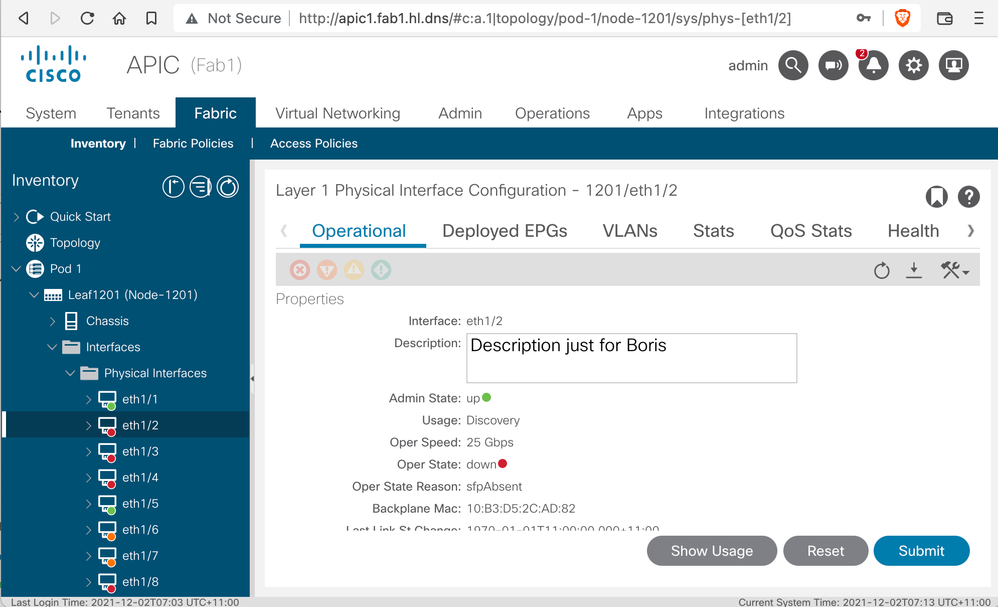

Now let me add a description the way YOU described on interface 1/2 (which, BTW should work - clear your cache is probably the best idea as @Robert said)
And sure enough, it turns up as the description in the object store
So far, so good
