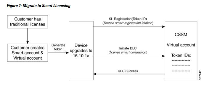

Hi
There´s a procedure to change from traditional licensing to smart licensing. If you already have Smart Account  you can follow this procedure and have all you licensing on the smart account.
https://www.cisco.com/c/en/us/td/docs/ios-xml/ios/smart-licensing/qsg/b_Smart_Licensing_QuickStart/b_Smart_Licensing_QuickStart_chapter_011.pdf
