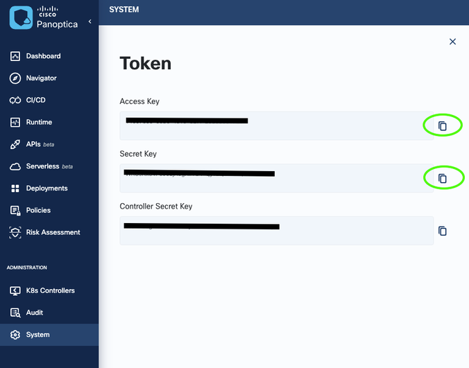

Step 4. Obtain Access Key and Secret Key for the API Escher authentication
After logging onto the panoptica.app site you should see the following screen (below).
Click on System to go to System page.
Click on MANAGE USERS then click on “+ New User”.
Once New User window pop up select role as “Service User” then provide a name, for example “api_user” then click FINISH button.
You should see a Token window pop up. Copy the Access Key and Secret Key and keep them in a safe place. These will be the keys to use escher authentication for the API request.
