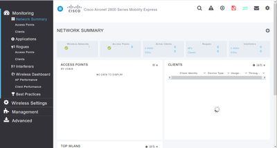

i have an AIR-AP2802I-E-K9 in autonomous mode and i can't configure it when i connect into the web interface i see 0 acces point

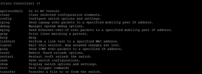

when i go in the access point with putty i cant go in the CLI im block in "Cisco Controller"

That's its because ME has two context one of them is the controller itself, the second is the AP in mode capwap. You need to do this steps:
  • Go to cli controller context and type: apciscoshell
Then you will have to enter the AP management credentials that you configures in the WLC Wizard
  • Once you are login in the AP context you will see the prompt change to <ap_mac_address>
  • Type enable and enter your credentials.
Then Type: capwap ap primary-base <WLC_NAME> <IP_WLC>
The WLC name is the name of your ME AP and the IP that it's using
