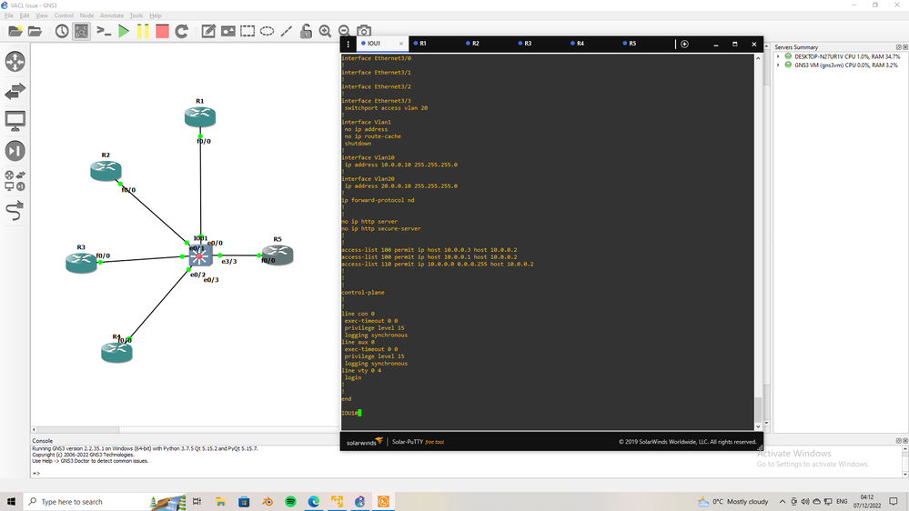

I think about your issue last night, only solution I found for
make only one Host connect to Server that both in same VLAN and prevent other host of same vlan  from connect
and make any host in other VLAN connect to server is using VACL
R3,R2,R4 share same subnet
I config VACL to make R3 can ping R2
but
R4 can not ping R2
AND
R5 (which is different VLAN) can ping R2.
R1 is GW for both VLAN
take look to my config
